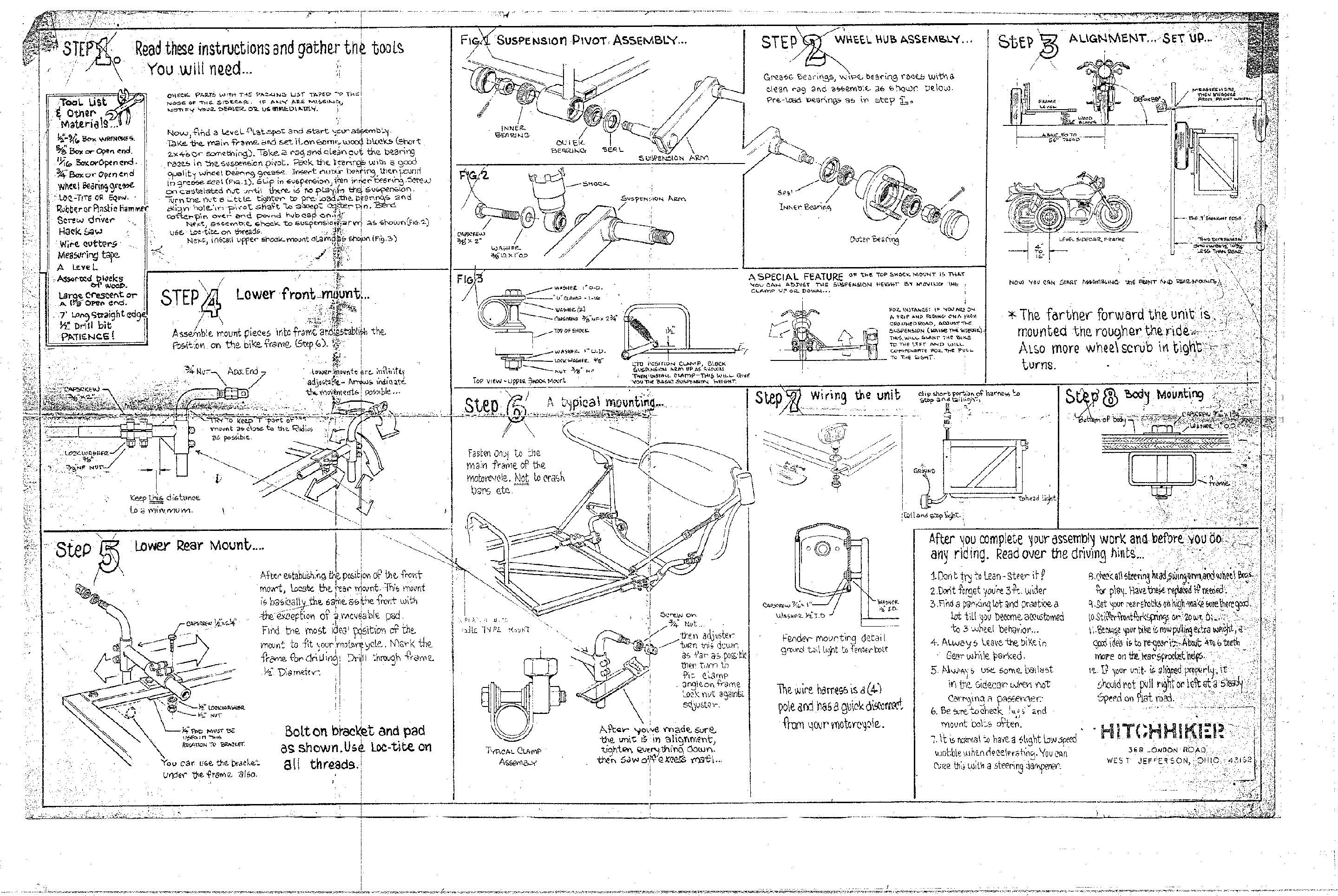

Does anyone know where I can get/buy building plans/blueprints for a sidecar? I want to build my own from scratch and have never had any contact with a sidecar, I just started riding a street motorcycle therefor never looked at one even up close and not sure how they have to be built to work properly, thanks for any help, Ryan Stephens

As far as I know nothing like this actually exists. But if you are looking for pointers on building a frame these installation instuctions might be helpful. I'm not so keen on how it mounts to the bike but that's how Hitchhiker did it I guess.
