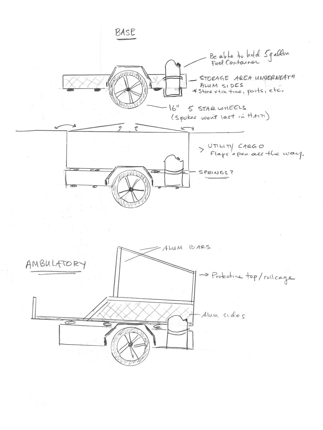

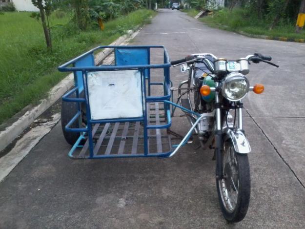

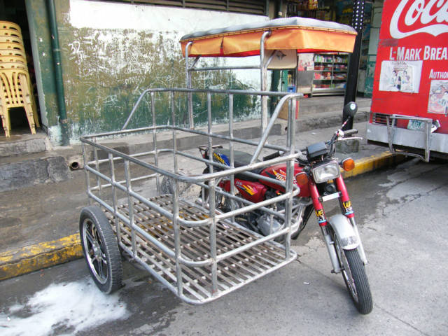

So here's what I'm talking about below. A few things to consider are:

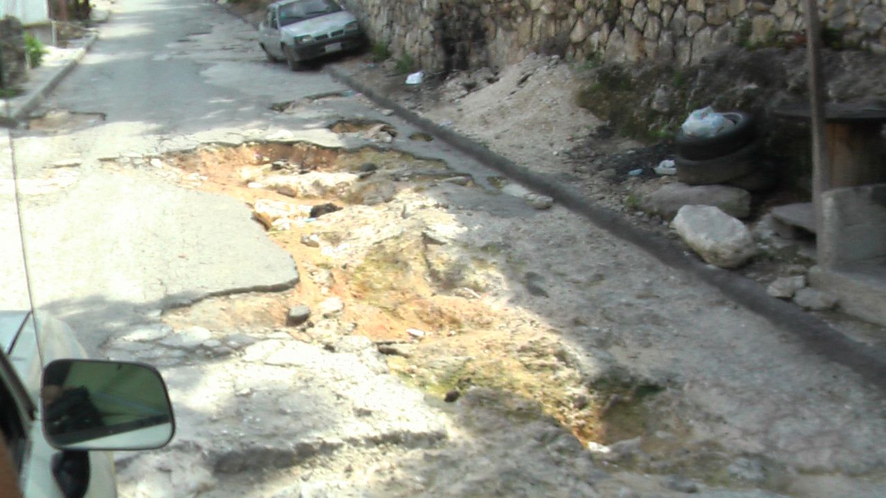

1. Road conditions are atrocious in Haiti. Imagine the worst road you know then multiply it by 100. You guys who have been to Iraq know what I mean.
2. Its rainy and wet there almost all year long. Things rust quick
3. The storage area and 5 gallon gas can are mandatory. In rural Haiti, even if there is someone to help you, there are no parts. You need to be able to carry an extra tire, tools, essential parts on board.

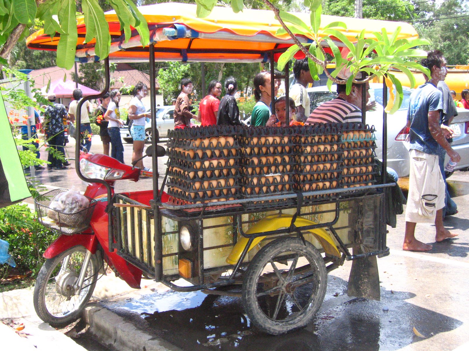

4. Lightweight, innovative sidecars are very popular in the Philippines. See examples>> http://www.olx.com.ph/q/sidecar/c-379
5. Buying and importing is not an option. Way too expensive here and also expensive to ship.
6. These are 3rd world sidecars. They need to be safe, but certainly not high end. Also, the bike and sidecar will most likely never do over 40 MPH

Here in the big island of Hawaii, the single most commonly seen motorcycle vehicle is the Honda Ruckus.
It is only 50cc but it is very rugged. They are used even on the ROUGH back roads to get to unknown beaches.
They only have a top speed of 35MPH but on an island that is acceptable. I suspect that as poor condition as Haitian roads are, that might be an intelligent speed anyway. Locals have ingenious ways of carrying cargo on these things and they get about 100 miles to the gallon. For your stated purpose and going for extreme economy and ruggedness, I would suggest an engine power unit from one of the Chinese manufacturers of scooters in a frame made by your local talent using large fat scooter tires like the Ruckus. I would suggest 200 to 250cc and a variable ratio torque drive such as are common to modern scooters. I would suggest making the sidecar frame integral to the scooter and not detachable. This would make it stronger while allowing it to weigh less. If it is as big as 250cc, it should be geared for about 55 MPH top end. With a variable drive this would give good bottom torque for rough off road situations. Include a strong pad eye welded to the front of the frame where a come along or block and tackle could be hooked for extreme mud rescue.
A cargo box sidecar could have an accessory seat if desired.
The Honda 250cc Ruckus would be perfect except it is no longer made and was too expensive. Google up a photo of the 2006 Honda 250cc Ruckus called the Big Ruckus. You will see the perfect design for what you are trying to do.
Do not try to fabricate out of aluminum. Use steel. sidecars are subject to shocks and vibration on rugged roads and aluminum would not last.
I have had ten sidecars in my life and built half of them myself so I have some experience to draw from.

Thanks for the info on the Ruckus, but as others have suggested, these are not available in Haiti and way too expensive. The smart way is to buy what's available locally where parts are also available. I agree about steel vs aluminum. We can get steel cheap in Haiti and can powdercoat cheap as well.
The kind of info I need is:
1. What tubing is easier to work with, round or square? (I'm guessing square)
2. What size is sufficiently strong yet keeps the weight down? 1 1/4", 1 1/2". What gauge?
3. Where can I get info on wheels, wheel assemblies?
4. Is a spring system better than using a shock?
etc etc etc
I can't believe no manual exists for this basic stuff?

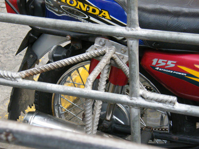

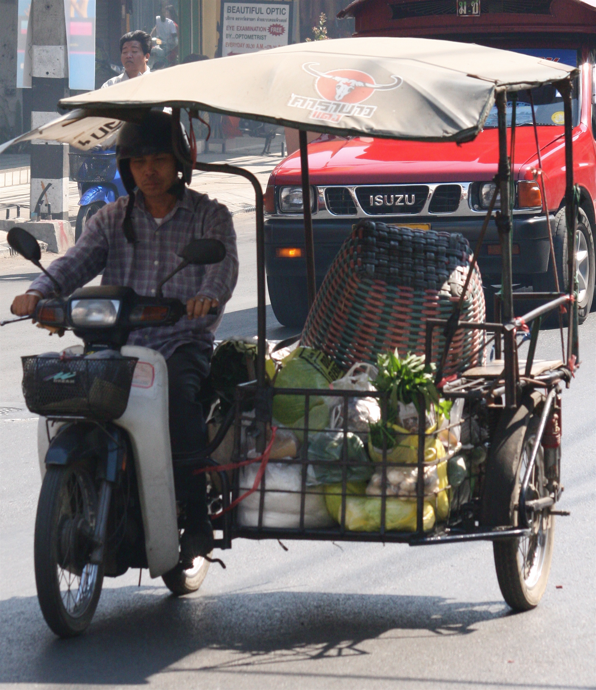

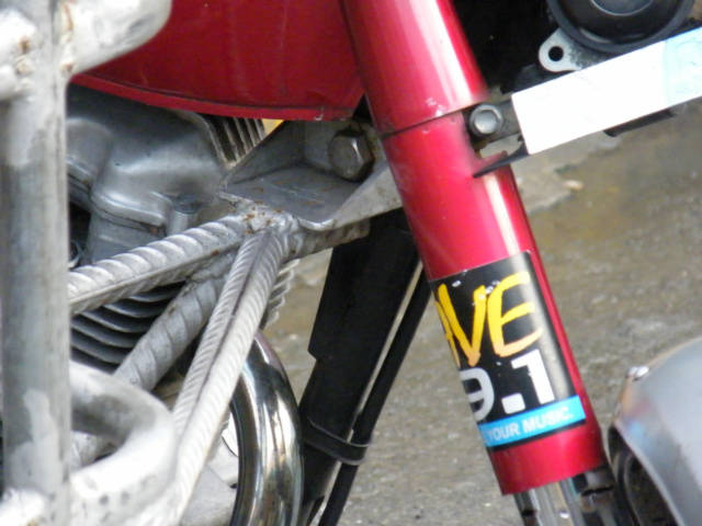

I understand what you are saying but again, this is not about building high performance sidecars. Safe? Yes, but just like Philonius mentions, they need to be simple and efficient. We are talking about functional machines here. If you look below, I have included sidecar pics from the Philippines and Thailand, two places where sidecars are used extensively for daily use. There is even a guy who sells them on eBay for $1400 including shipping from the Philippines to NY.
Haiti is extremely mountainous and the roads are treacherous. In this situation, its a matter of function over form. They don't need to be pretty, or built to go 70 MPH. They WILL break there. They need to be simple so they can be easily fixed and cheap to produce. Rarely will you be going 40MPH. In fact the Chinese bikes there are geared low for the terrain.
I am continuing to do research on design and have found an experienced sidecar and trailer builder in my area. I also have recruited the help of an experienced welder instructor from my local community college. Maybe we can come up with a KISS design. In fact, last night, the discussion was on pull behind trailers vs sidecars. This way we can use any bike available as long as it can pull the trailer and still keep the bike free for other uses. It's a thought.
Check out the pictures below. I love their simplicity and ingenuity. I guarantee none of these cost more than $1,000 to buy.
Check out the rebar being used to attach the bikes. Now THAT'S homegrown ingenuity, using easily available products. Maybe I need to make a trip to the Phillipines and Thailand and do some homework...
Posted : January 16, 2011 3:12 am

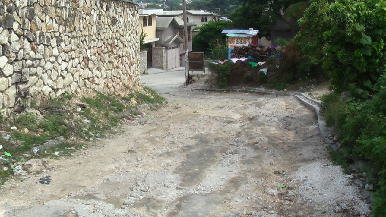

Great info. Thank you to both of you. So can I ask some very basic questions so I make sure I'm on the right track?
1. In Haiti, there are "couchmen" everywhere. They are tire guys. They fix tires. When I tell you that Haiti roads are on par with Iraq, I'm not kidding. The good thing is you can find a "couchman" EVERYWHERE at any time of day or night. So even though it adds more weight, it would make sense to have a regular car rim with car tire on it. A specialized wheel with special tire would be a pain. However, I imagine that a sidecar rim and tire with a tube would be something that's reasonable repaired. Can you suggest a source or recommend a wheel/tire?
2. The torsion axle suspension unit you recommended looks great but I'm wondering if a leaf spring system wouldn't be easier. Again, more weight but going back to the original purpose, it ois something familiar, and repairable there. Any thought on that?
3. I know that round tubing has more flex that square tubing, but is it a marked difference? I can get and use round no problem. We would just need to get a mechanical bender there.
4. What is the best balance between weight and strength for frame tubing? My Velorex looks like its 1 1/2" tube. Do you have any idea what guage it is?
Right now, between the three of us, we are working hard to come up with a plan. If we can gather info we need, and get the PARTS, we'll try a mockup as soon as we can.
I will be in Haiti Feb 18-25 and would like to be armed with info so as to see what items are available, what are not, find people with the right skilss, etc
Thanks for any help!!!!
PS Attached are photos of some typical Haitian Roads (these are PRE-earthquake)
Posted : January 16, 2011 2:08 pm
