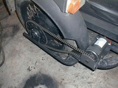

I have a photo of one that uses a bike rear sprocket bolted to the SC wheel inside, and uses an auto starter with a lever going to the bike side, to pull the starter into the sprocket to mesh the gear for backing up.
This is what HD used to have for their sidecar. It had a ring gear that went on the sidecar wheel with a cast steel bracket for a car starter, relay and associated wiring. They used an extra battery that mounted in the sidecar trunk. I believe the extra battery was parallel to the motorcycle battery in order to get a charge.
It was rather pricey even ten years ago, around $1,300 as I recall. They no longer make these since they didn't sell very well. It required that you devote the whole sidecar trunk to the battery since with the acid, nothing else could be near it.

OOOPS, I also forgot about those who have trouble pushing the rig backwards out of garages, or drives. but, if its possible, drive the bike around and roll back down into the garage if it slopes into it.
anyway, here's the pic I was talking about..crude, but can give many an idea what works.
