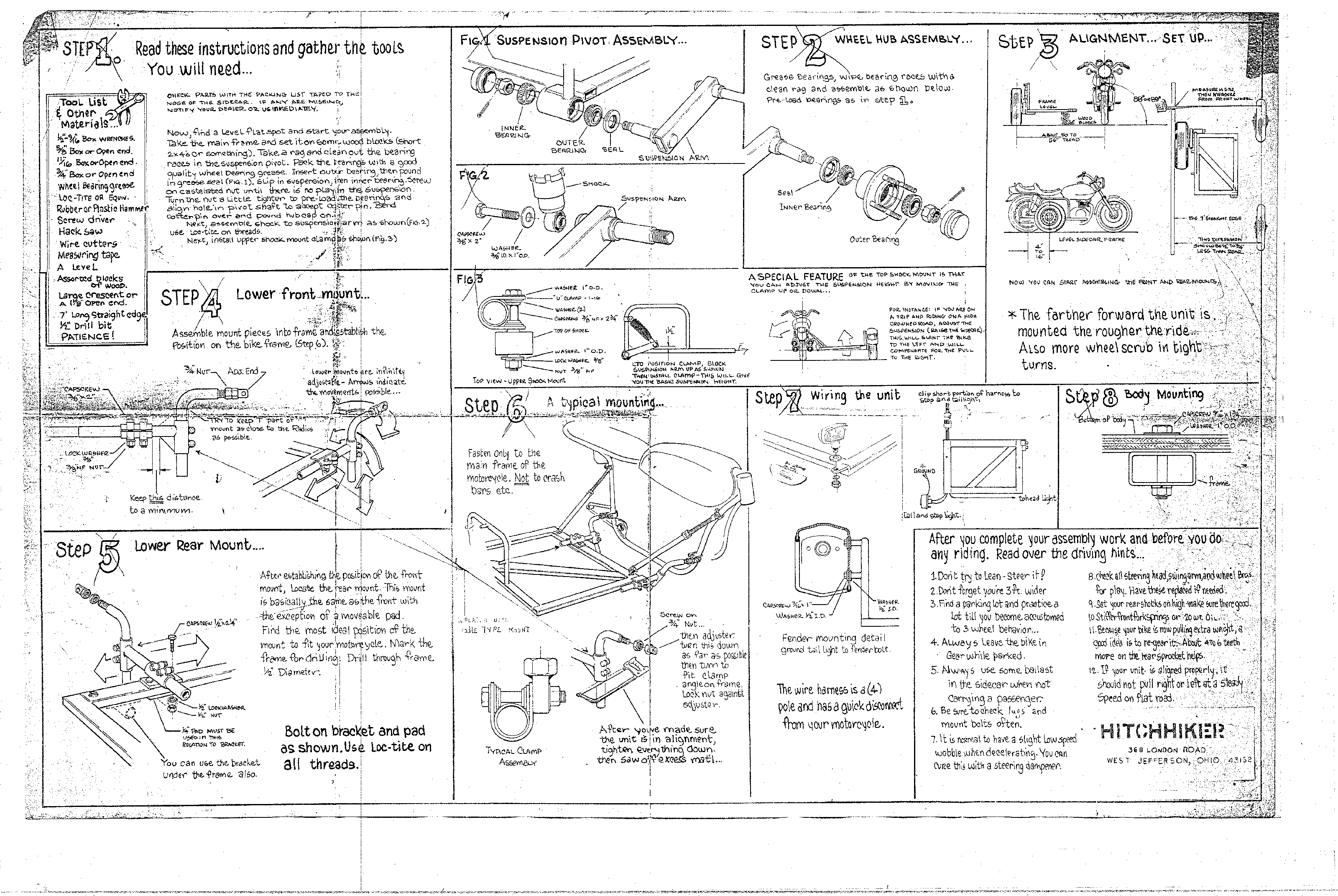

The file attached below the photo is all you got when you bought a new one.
As a former HitchHiker/Goldwing owner, pay particular attention to your mounts. I used to bend them on aggressive left turns. I eventually moved it to a smaller bike. I know others here had good luck with the combination, though.

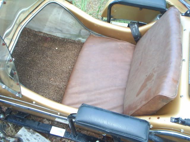

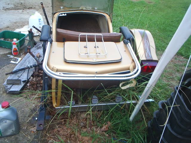

Let me see if I can get a pic in here of it for you guys.
Ok, it works! Got the pics in. Notice it even has a trailer hitch bar already on it so we'll see how it does with the trailer hooked to it and the bike to see which way will be better.
Here's the link to the rest of the pics of it.
http://s289.photobucket.com/albums/ll201/Bagmaster50/New%20Bike%20Shots/Hitchhiker%20sidecar/
Tire side
Seat pads and arm rest
Rear view
Posted : August 20, 2009 5:37 pm
