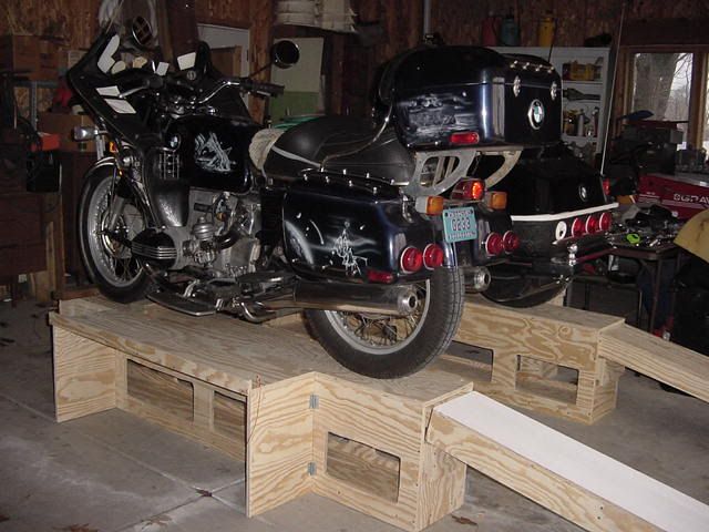

this is what I use, besides a standard auto jack or ATV lift.

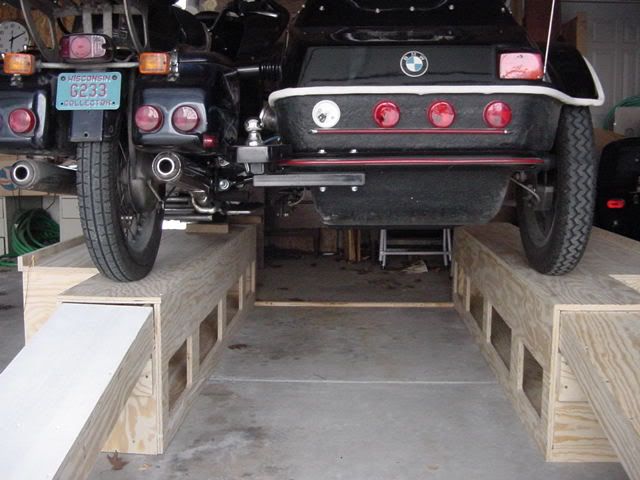

Forgot to mention that I really like the way you designed your platform with the swing out tool/parts area, good idea.

storing is no problem...the ramps slide inside the main parts for stroage and the side work areas fold flat against the main part also. then you stack one on top of the other... you end up with a floor space of 18" by 8 feet..easy to slide against a wall somewhere.
Posted : March 2, 2007 4:13 am
I forgot to mention that an auto jack or scissors jack can also be used on the platform to get the wheels odf the surface...bike OR sidecar wheel.
for quicky lifts I just slide my ATV hydraulic lift[$90 at local store] under the bike and an auto jack under the SC axle...then pump away!!
Posted : March 2, 2007 4:19 am

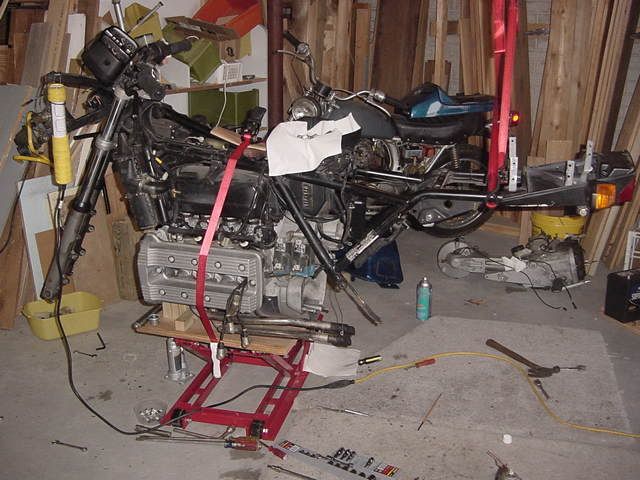

I don't have a lot of room in my garage. I just use a Harbor Freight roll around floor jack and cribbing. If it will lift my 3/4 ton Ford truck, it'll lift my sidecar rig. I even built a drop in motor cradle that makes removing and installing the engine a breeze

to those who want to build, or modify the ramps... it is not my design. I found it on the net...here is the link.
http://www.midnightfantasy.com/cyber/shop/workstand.html
you can click on the various EXE's for 3D moveable pics of the parts also.
after opening the window click'run' then 'animate ' then the drop down opens ..click 'continuous play'
have fun!!
