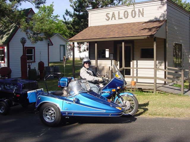

here's a pic of the light I put on my /5 rig.

OK, Wayne,
glad to help. I was looking at your pic, and it might be possible to put the front signal light on the side of the SC. but far enough forward as to be seen from the front. but, better on the top right corner of the nose. on the side it wont be seen from oncoming, or cross traffic to the left of the bike.
good luck! and ride safe!
Posted : December 21, 2006 6:36 am
