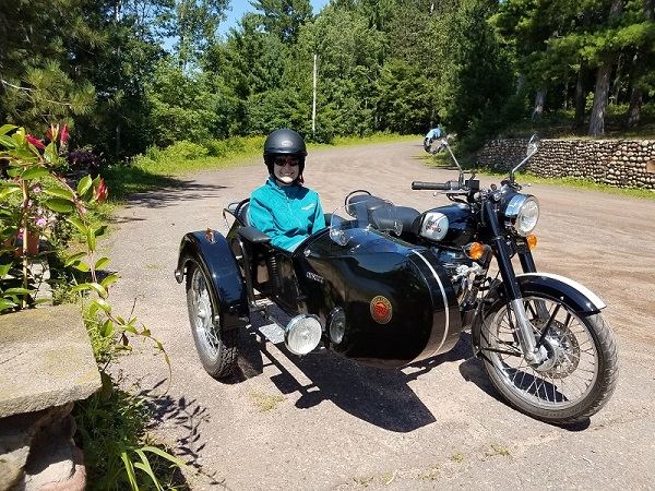

Sidecar newbie first post hello! Thanks to all who helped me with my login problems. Oh, and don't do it! Don't buy a cheap sidecar from an Ebay seller with sketchy feedback. That's not really fair, in the end the seller did exactly what he promised and the car is probably worth the low price I paid for it, but boy what an aggravating transaction. I followed the newbie handbook and bought first, researched later, I never seem to learn. If I'd had my wits about me I would have bought something nicer but despite the iffy construction I quite like the thing, actually I'm having a total blast! Who knew attaching a Buck Rogers kiddy car to a motorcycle could be so much fun. I bought it intending to pair it with my little Honda Rebel, well in the end that wasn't going to do, so I sought out an appropriate bike for an Indian made sidecar. It was classic incrementalism, I think it's a natural defense mechanism that protects my fragile mind from the scope of what I'm about to do, it seems to be an important process in my life.
The body of the car presents well, and the frame and swing arm seem sturdy. There's some crooked welding, is it unfair to complain about lack of symmetry on a sidecar? The floor is thin, I cut a piece of plywood from the crate it came in and bolted inside to support climbing in better. I also reinforced the step, it was apparent it wouldn't last long as it was. The mounting struts and hardware were pretty much garbage, replaced struts and did a little fabricating, thanks Mr. Wark for his advice. I'm currently using just one of the original frame clamps, plotting how to do away with it too. 900 miles on it now, everything has remained pleasantly solid. I also replaced the horrible seat, still working on the horrible armrests. It came with a windshield, couldn't stand the poor quality so I found this neat little deflector, it's surprisingly effective. I bought the RE Classic 500 new from a dealer, pretty affordable for a new motorcycle. It has plenty of torque for city driving within it's narrow power band, no good for the highway but it's a small bike and I'm not into speed. Weighting it with the sidecar smooths out it's notorious engine vibration a lot, it's a good match. Currently about 5/8 inch toe in, 7 inch wheel lead and 1 degree lean out. Pull still tends lightly to the right, more prominent at high speed but not really bothersome at my normal driving speeds, still thinking about it. It seems very stable, it felt good to me pretty quickly, even better with my wife along. I did the stand on the left foot peg and lean out test, I'm 190ish pounds and I can't get the wheel off the ground without pretty hard jerking and then only just.
