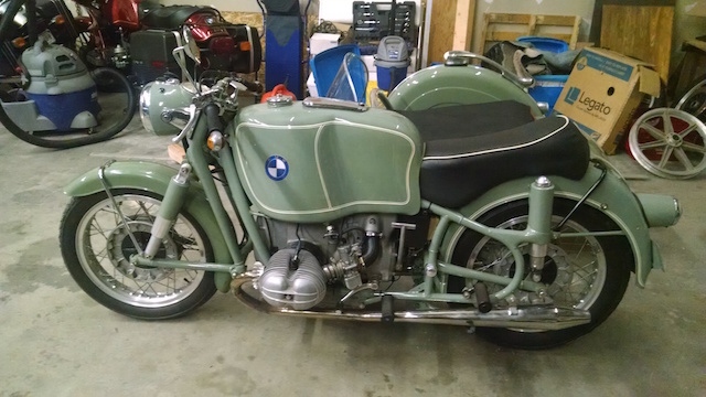

Quote from Donmystic1 on February 11, 2015, 6:49 pmHere is a picture of my 1965 R50/2 with a Steib S 500 attached. The R50 has a 1970 R75/5 motor and transmission

Quote from Claus on February 13, 2015, 4:45 amJ.R, the final drive gearing might be a bit high (Autobahn) with the original engine. The 75/5 engine has got much more power. That should do quite well with the 18" wheels. It´s near perfect in my opinion
