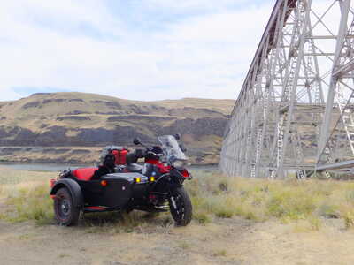

Throwback pic from 2015.  This is how trains cross the Snake River in Eastern Washington. (click for big pic)
DSCF0078
Lyons Ferry, Washington.  Passenger is Kirby the Sidercar Dog.

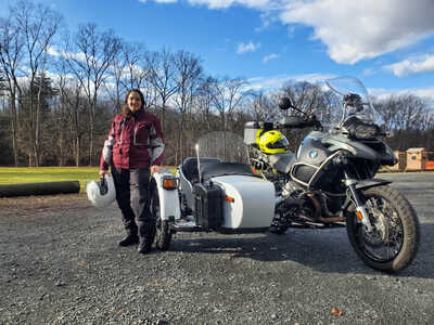

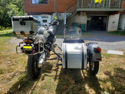

This one is less about where and more about who with.

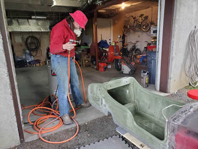

If you read the RGSA/URAL build thread, you saw Chloe did a significant amount of work on the tub.
https://sidecar.com/forum/technical-discussion/2011-r1200gsa-with-ural-tub-build-part-4-up/
Bodywork, loads of sanding, paint, etc.
GSA part7m
GSA part7m3
GSA part7r
After putting several hundred miles in solo (except bags of concrete), I was sure the rig was safe and my skills were dusted off.  (Been a year and three months since the wreck and the first solo ride).
By then weather and time was against us but FINALLY we got a decent day - 55F in December in PA.
No way I was missing this chance so Chloe and I bundled up and trundled off.
Immediately I felt a difference in handling.  Chloe moves around a lot more than two bags of concrete and, damn, does it make the rig corner better.
I looked down at one point and could see her smile through the opening in her full face helmet.
Riding with her was a huge motivation in going to sidecars - not only can we do it together but she is an active part of the ride.

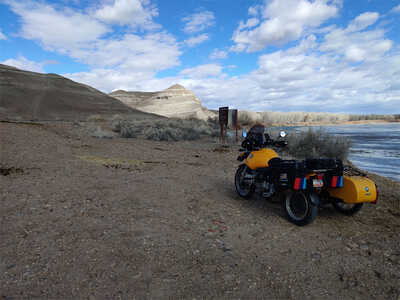

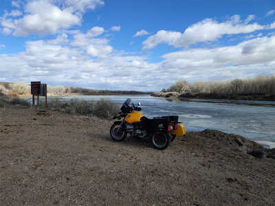

Today was the last decent weather day before the next round of inclement weather blows in (literally).  Took advantage of the day by cruising the back roads out to the Ouray National Wildlife Refuge.  Imagine my surprise when it turned out to be actual animals, like coyotes, not a bunch of burnt out college students.  Who'd have thought? 😉
In any case, here is the basic loop:
2567 image
Since it didn't quite make it to 60 degrees F, the goal was not to go up in elevation.  Something that happens quickly, and easily living in a basin.  This route pretty much skirted around and over benches, and not much higher than 6K feet elevation.  Normally this would all be under at least a foot of wind driven snow.  This year is a bit of an anomaly.
Green River still a bit iced over, but pretty thin ice at that, and some good flow in the shallower areas.
Green River
boat launch on Green River
 Out in the middle of nowhere at the dead end of a dirt road, a good 7 miles from any paved road was this.  I didn't know Powell had lost an arm in the war.  Provided a whole new level of respect for the man, exploring a pretty wild and treacherous region.
courageous journey
This is the view:
courageous journey overlook
Managed to put another 180-ish miles of ear to ear grin type fun on in the past three days.  Just another 3 months before the "real riding season" begins. lurker
